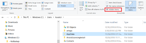

| Operating system | Location of temp directory |
| Windows | As defined by the TEMP environment variable
Use echo %TEMP% to find the exact location |
