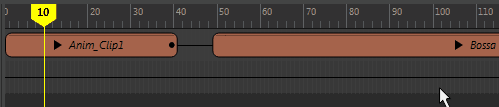

  3. Select the clips on the track, right-click and select Create Transition from the Time Editor Clip contextual menu. The empty space between the clips on the track is filled by a grey bar to show that the clips are joined with a Transition.
  4. To delete a transition, right-click the clips that surrounded by the transition and select Reset Transition from the Clip contextual menu.
