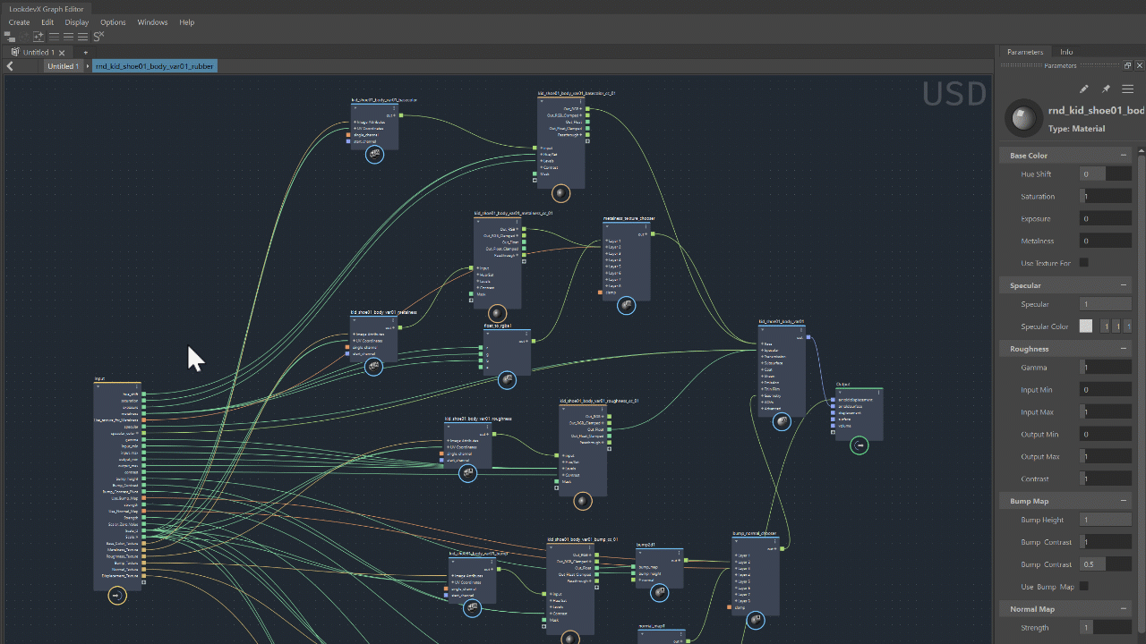

Hide input nodes
In LookdevX 1.4, you can hide input nodes with a simple right-click to keep your graph clean. You can also view connection details by hovering over the extended port.

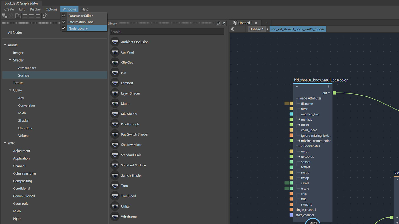

Node library
The new node library enables quick browsing and selection from categorized nodes, enhancing your overall efficiency.

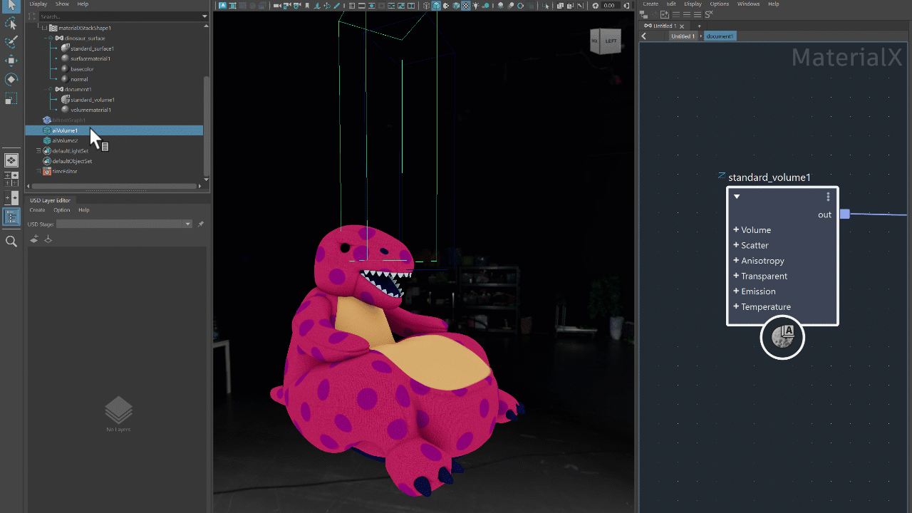

Support volume shaders
In addition to surface and displacement shaders, this update also supports volume shaders in the MaterialX data model.

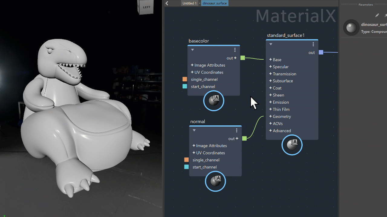

Viewport support for Arnold materials
The latest update allows Arnold materials to be displayed in the viewport when using the MaterialX data model. Currently the supported nodes include:
- standard_surface
- image
- color_correct
- abs
- add
- complement
- cross
- divide
- exp
- float_to_rgb
- float_to_rgba
- fraction
- max
- min
- mix_rgba
- modulo
- multiply
- negate
- normalize
- pow
- reciprocal
- sign
- sqrt
- subtract
Note:
This feature requires Arnold 7.3.2. See install Arnold.
