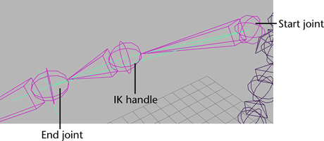

IK handles overview
In an IK chain, the joint where the IK handle begins is called the start joint and the joint where the IK handle ends is called the end joint. All the joints between the start and end joints are driven by the IK handle and its solver. In the scene view, the IK handle is drawn as a line from the start and end joints of the IK chain.
The end of the IK handle, which is located at the last joint of the IK chain by default, is called the end effector. When you move the IK handle, the IK solver uses the end effector’s position and orientation in its calculations to rotate the joints in the IK chain accordingly. The end effector tries to follow the IK handle’s position at all times. However, depending on the rotational limits and fully extended length of the IK chain, the end effector might not be able to reach IK handle.
