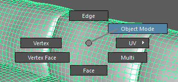

You can quickly access many of your most commonly used tools with marking menus.
Marking menus are used throughout the Maya interface. When you right-click an object, a marking menu appears that lets you select a selection mode and other actions that are in context to the type of object. Some marking menus appear when you hold a key and press a mouse button.
Marking menus are very fast for experienced users because once you get used to showing them and the positions of their items, you can select the items using very quick gestures with the mouse or tablet pen, sometimes so fast the entire menu won’t even display.
To select an item from a marking menu
- Do one of the following:
- Right-click anywhere in your scene when an object is selected, and release the mouse button.
The marking menu remains on the screen, letting you move your cursor over the item you want to select.
- Right-click anywhere in your scene when an object is selected and continue holding your mouse button and drag in the direction of the item you want to select. It doesn't matter how far you drag or if you hit the item exactly. This allows you to make the drag very quickly. Dragging over an item with a submenu attached shows the submenu.

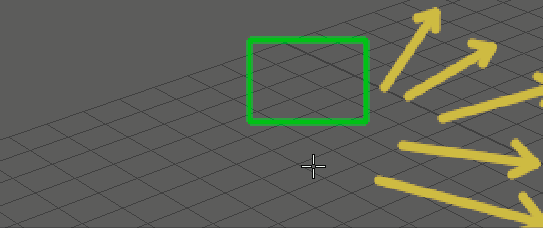

Blue Pencil Marking menus
The Blue Pencil Marking menu gives you intuitive access to frequently used actions. Right-click when Blue Pencil is active to show a menu of Blue Pencil tools.
| Menu Item | Effect | |
| Transform | Activates Transform mode, which lets you select an area of a drawing and translate, rotate and scale it.See Modify drawings with the Blue Pencil Transform mode for steps on how to modify your Blue Pencil drawings. | |
| Draw | Expands to show a choice of Blue Pencil drawing tools. Click the option box next to the name of the tool you want to use: | |
| Pencil | Lets you draw freehand in the Viewer Window. | |
| Brush | Lets you draw freehand in the Viewer Window. | |
| Eraser | Erases brush strokes on the Blue Pencil sketch at the current frame. | |
| Text | Adds a text box to the scene where you can type. | |
| Line | Drag across the screen to create a straight line. | |
| Arrow | Drag across the screen to create a line capped with an arrowhead. | |
| Ellipse | Drag across the screen to create an oval shape. | |
| Rectangle | Drag across the screen to create a square shape | |

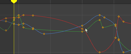

Graph Editor Marking menu
Shift + S +click in the Graph Editor Graph View to display a marking menu of options for keys (swipe left) and Tangents (swipe right). See Keyframe Tangent Marking menu for a description of the options.
Polygon / NURBS marking menus
Right-clicking a polygon or NURBS object in the scene brings up a marking menu of many commonly used commands.
| Components | The upper radial section of each object type displays options to change the current component selection mode for that object.
Note: Objects remain selected even when switching between various object and component modes.
