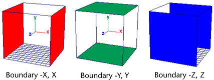

Boundary X, Y, Z
The boundary attributes control the way the solver treats property values at the boundaries of the fluid container.
For each boundary select one of the following boundary definitions:
None
Makes all boundaries of the fluid container open so that fluid behaves as though the boundary isn’t there.
Both Sides
Closes both boundaries of the fluid container so they act like walls.
-X, -Y, or -ZSide
Closes the -X, -Y, or -Z boundary, respectively, so it acts like a wall.
X, Y, or Z Side
Closes the X, Y, or Z boundary, respectively, so it acts like a wall.
