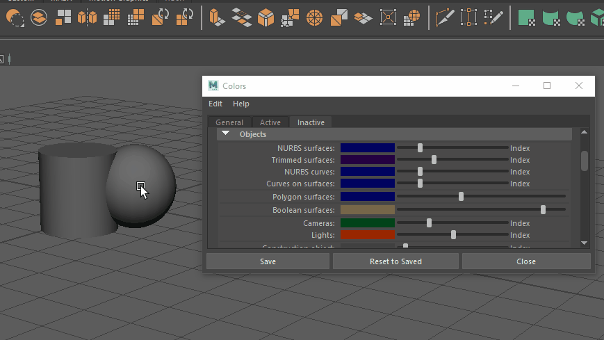

To customize the wireframe color of boolean input objects
  1. By default, boolean input objects display as orange wireframes, differentiating them from other objects in your scene. To customize the wireframe color of your input meshes, do the following:
    • Adjust the Boolean surfaces slider in the Color settings (Windows > Settings/Preferences > Color Settings > Inactive > Objects).
