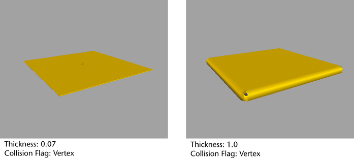

Thickness
Specifies the radius or depth of the current nCloth object’s collision volumes. nCloth collision volumes are non-renderable surfaces offset from an nCloth’s vertices, edges, and faces that the Maya Nucleus solver uses when calculating self-collisions or passive object collisions.
Collisions occur at an nCloth’s collision volumes, not at the surface of the nCloth object itself. The following collision volumes are used by nCloth: collision spheres for vertex collisions, collision cylinders for edge collisions, and collision planes for face collisions. Each collision volume on an nCloth has the same radius or depth unless overridden by a Thickness Map.
Thickness also determines how thick your nCloth appears.
For example, a value of 0.0 creates thin nCloth (such as silk) and a value of 1.0 creates thick nCloth (such as felt).

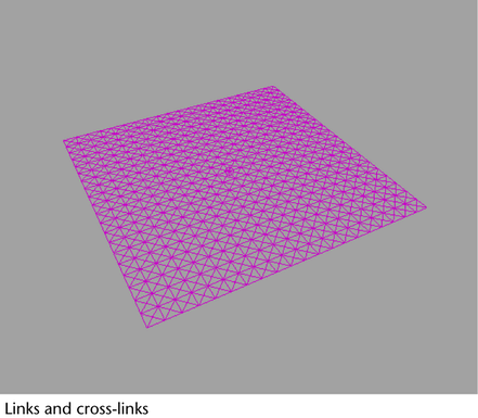

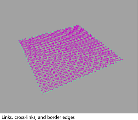

Stretch Links
The nCloth’s stretch links are displayed in the scene view.
Bend Links
The nCloth’s bend links that are used to calculate bending in the nCloth are highlighted in the scene view.
