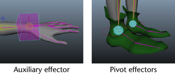

You can add auxiliary and pivot effectors to a character’s Control rig to provide another level of IK control. See also Control rigs, effectors, and pivots.

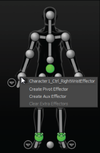

To add auxiliary or pivot effectors
- In the
Character representation of the
Controls tab, right-click an IK Control rig effector cell.
- In the menu that appears, select
Create Aux Effector or
Create Pivot Effector.
The auxiliary or pivot effector is placed at the same position and rotation as the corresponding IK effector.

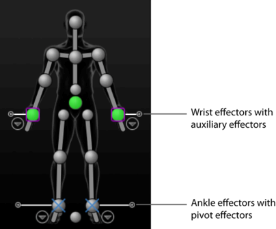

In the Controls tab, the effector cell updates to indicate the effector now has auxiliary or pivot effectors.

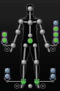

(When you create auxiliary or pivot effectors, cells update to indicate the current object. The current effector is either the last created, or the last selected.)
- If you have multiple effectors per cell, click the + icon to expand the cell and select the effector you want to set as 'current' for the corresponding cell.
You can then collapse the cell view and continue to select the current auxiliary effector or pivot effector by selecting that cell.

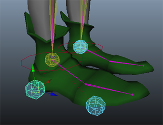

To adjust the position of pivot effectors in the scene
- Select the pivot effector you want to adjust, then select the Move tool
Move manipulators display on the pivot effector.
- Press D + drag to position the pivot effector.
Tip: You can also press Insert + drag to move pivot effectors independently from the rig.
The D and Insert hotkeys let you move pivot effectors independently from the rig. Moving the pivot effector without pressing D or Insert lets you adjust the position of the character.
