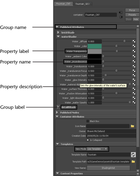

The following illustration gives you a brief overview of the view XML elements and how they display in the Attribute Editor.

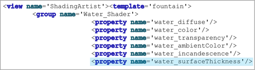

To remove attributes from a view
- Within the view definition, delete the <property> element that represents any attribute you don’t want to display in this view.
- Save and close the XML file.
When you reload the template in Maya and select the modified view as active, the attributes corresponding to your deleted <property> elements no longer display in windows and editors.
By default, all attributes from the template are added to the view when you create it. The attributes are represented in the view definition by <property> elements. The <property> elements refer to the attributes available in the template by name.
You can edit the view definition to remove any attributes you don’t want to display in a particular view.

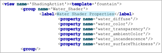

To change the display names of attributes in a view
- Add a <label> element to the property definition if it does not already have one. Tip:
Make sure you delete the trailing slash / at the end of the property definition and add a closing </property> tag when you add <label> tags to a property definition.
- Edit the text string within the <label> element.

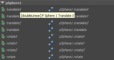

Note:Changing the <label> text also changes what displays as tooltip help for the attribute in the Asset Editor. By default, the Asset Editor displays tooltips based on the attribute’s <type> and <label> elements.
In each view, you can use <label> elements inside each property definition to change the name that displays for the corresponding attribute in the Attribute Editor.

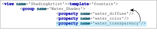

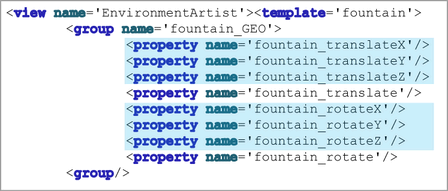

To re-order or re-group attributes in a view
- Within the view definition, select and cut an entire <property> element.
- Paste the element to a new location within the view definition.
- When you are finished reorganizing attributes in the view, save the XML template file and close your XML editor.

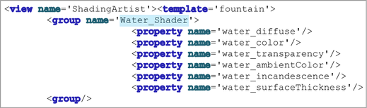

To change the heading for a group of attributes in a view
- Do one of the following:
- If your group name does not need to contain spaces or special characters, simply edit the name text string within the <group> element.
- If you want your group name to contain spaces or special characters, add and edit a <label> element to the group definition.
Before proceeding with these steps, ensure that you select the Group By Node layout in the Add View Options as you create the view.

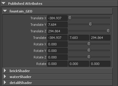

To display child attributes with individual controls in a view
- As you add the view to your template, ensure that Expand Compounds is turned on in the Add View Options. (See also Add a view to an asset template.)
When Expand Compounds is on, the child attributes of compounds are added to the view definition individually.
Consequently, they display with individual controls.
- (Optional) If you want to display only the child attributes (with their individual controls), you can remove the parent attributes (and their group controls) from the view definition. (See also Remove attributes from a view.)
To display only group controls for compound attributes in a view
- As you create the view, turn off Expand Compounds in the Add View Options. See also Add a view to an asset template.
When Expand Compounds is off, child attributes are not individually listed in the view definition, so the parent attribute (with its children) will be displayed using a group control.

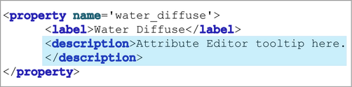

To change tooltips that display in the Attribute Editor
- Within the view definition, find the property definition with tooltips you want to edit.
- Add a <description> element to the property definition if it does not already exist. Tip:
Make sure you delete the trailing slash / at the end of the property definition and add a closing </property> tag if you are adding <description> tags.
- Enter your Attribute Editor tooltip text between the <description> tags.
- (Optional) If you want the tooltip text to display in a different language, you can also add <language> tags. See Localize the asset user interface and Localization elements: Interface labels and descriptions.
- Save the XML template file.
You can set up each view to display different tooltips as the users of your asset mouse over attributes in the Attribute Editor. This lets you display any information that will be helpful to your users.
