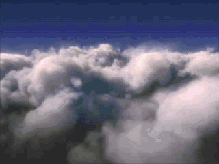

Realistic atmospheric effects, such as clouds, mist, fog, steam, and smoke. ![]() |

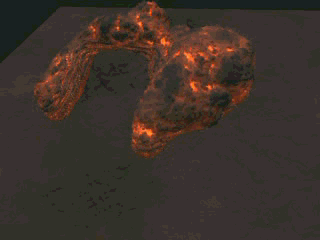

Viscous fluids, such as molten lava and mud. ![]() |

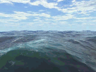

Open water, such as calm or rough oceans with white caps and foam. ![]() |
