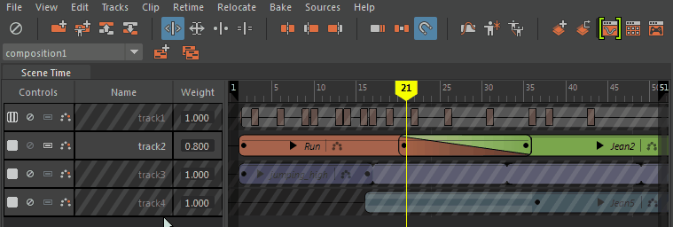

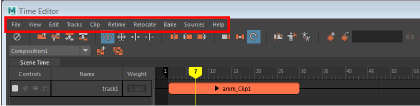

Time Editor menu bar
The following are options available from the menu bar at the top of the Time Editor user interface (UI). However many options and commands are also available through contextual menus that appear when you right-click different objects in the Time Editor. For these, see:

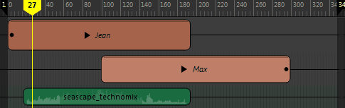

Frame All
Fills the time view with all the animation objects in a scene. The hotkey for this is A.
Frame Selection
Fills the time view with only the selected animation objects. The hotkey for this is F.

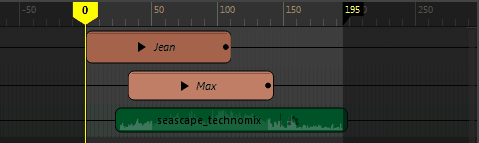

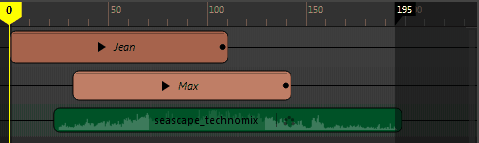

Frame Playback Range
Displays clips from the start frame to end frame. The hotkey for this is G.
Center Current Time
Frames the Current Time Marker at the center of the Time Editor. The hotkey for this is T.

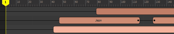

Trim
Lets you set the in and out points of a clip so that only part of the original source contributes to the clip. Select Trim from the Edit Mode menu, and place your cursor at the left or right edge of a clip. Notice the change in cursor look. Drag the cursor to trim.
A negative number on top of the clip indicates the number of frames trimmed.
A white dot on a child clip indicates that it is trimmed because of the parent clip. The white dot does not appear if a child clip is too small to display.
A black dot on the trimmed clip indicates that there is animation outside the clip.
See Time Editor Clip symbols for more.

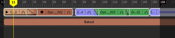

Bake
The Bake menu options let you merge multiple Time Editor animation clips into a single clip.
Bake to New Clip/Bake to New Clip and Delete
Merges the selected clip to a single clip, creating only the minimum number of keyframes necessary in the merged clip. Deletes the original animation, if specified.
Once you have baked your clips, you can perform editing operations on it as if it were a single clip. See Edit animation in the Time Editor.
Note: You can use Bake to new Clip with Group clips or multiple selected clips.
For more information about Baking clips, see Bake Time Editor clips.
Bake to Scene/Bake to Scene and Delete
Merges the selected clip(s) to the scene. Deletes the original animation, if specified.
Flatten Layers
Merges all Animation Layers of the selected clip into a single layer. See Key on Layer clips.
Note: You must have more than one layer to flatten layers.
