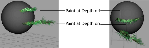

Paint at depth
When Paint at depth is off, the depth values of the paint change as you drag the brush into the scene. If the stroke has tubes, the tubes “grow” from the surface you paint. This is the default.
When Paint at depth is on, the depth value of the stroke is determined when you first click the brush, and is then fixed at that value. If the stroke has tubes, the tubes “grow” from the plane orthogonal to the path at each step. This is useful for creating effects where you want tubes to sprout out from the path (for example, a fountain, smoke from a chimney, or a tail). The Paint Effects Tool cursor changes to project ortho-normal to the view, to indicate you are painting at depth.
You cannot change this setting after painting the stroke.

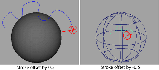

Surface offset
Set the distance (in world units) you want the next stroke offset from the object or plane you paint the stroke on. Offsetting the stroke is not the same as translating it. When you offset the stroke, the stroke is created normal to and a uniform distance from the stroke path, so if the surface is convex, the stroke will be bigger than the stroke path. Similarly, if the surface is concave, the stroke will be smaller than the stroke path. The cursor changes to reflect the displacement value.
Tip: You can use the m hotkey (ModifyDisplacement under Brush Tools in the Hotkey Editor) to interactively change the stroke offset. For information on other Paint Effects hotkeys, see Use default Paint Effects hotkeys.
You can change this setting after painting the stroke. For more information, see Modify stroke settings for existing strokes.
