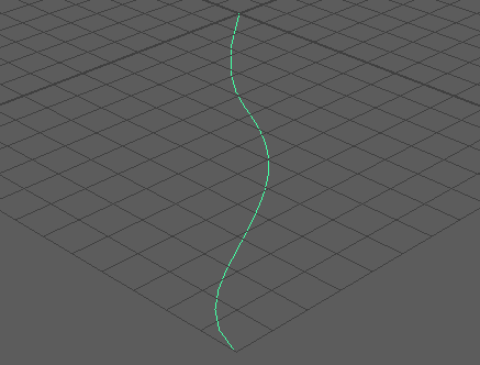

  1. Create a curve to be your base for the animation. (Select Create > Curve Tools > EP Curve Tool to draw out a curve.)

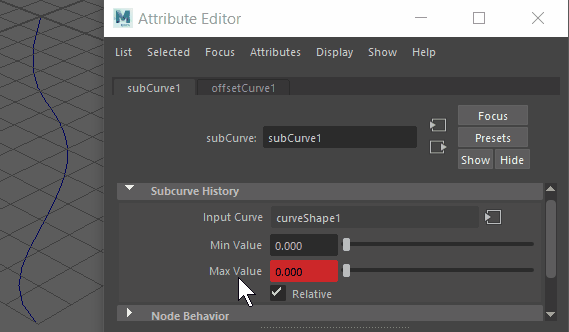

  5. With the new curve selected, open the Attribute Editor (Ctrl + A)
  6. Locate the offsetCurve1 tab, and click Input Curve > subCurve1 > (Upstream Connection).
  7. With the Time Slider at frame 1, change the Max Value of the Subcurve History to 0.00.
  8. Right-click the Max Value field and choose Set Key.
  9. Move the Time Slider to frame 120 and change the Max Value of the Subcurve History to 1.00. Right-click Max Value and set another key. Scrub the Time Slider to ensure the offset curve length changes from 0 to 1.

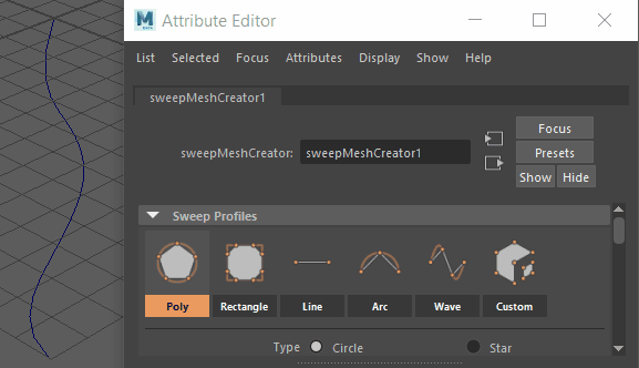

  10. Select the animated offset curve, and select Sweep Mesh from the Poly Modeling shelf or Create > Sweep Mesh in the main Maya Menu.
  11. Play back the animation. The mesh grows like a tube but the curve has angles.

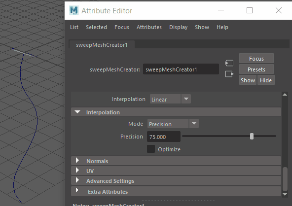

  12. In the Sweep Mesh Interpolation section, set the Mode to Precision, the Precision value to 1.00, and click Optimize. The mesh curve smooths out.
  13. Next, in the Taper Curve section, adjust the ramp so that the tip of the mesh thins to a point.
  14. Experiment with other Sweep Mesh options like Profile and Distribution.
