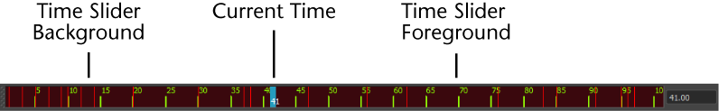

Key ticks
Key Ticks are red (by default) marks in the Time Slider that represent the keyframes you set for the selected object. When keys are selected, they appear white while highlighted blue (see Selecting keys on the Time Slider for an example). Breakdown keys are a special type of key displayed as green marks in the Time Slider.
To set the thickness of your keyframes in the Time Slider
  1. Select Windows > Settings/Preferences > Preferences.
    The Preferences window appears.
  2. In the Time Slider section, set the Key Tick Size preference setting.
    Key thickness is measured in pixels. The minimum key thickness is 1 pixel and the maximum is 63 pixels.

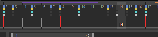

To show curve color coding above keys
    Right-click the Time Slider and select Color Coded Keys from the Animation Controls menu.
    Color Coded Keys are color "beads" that appear above key ticks that show on which curve the key was set: Translation (blue), Rotation (yellow), Scaling (green), or other (white) curve to give feedback on your animation.
