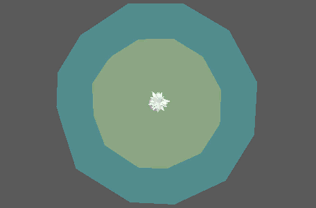

- Display Type
- Determines what the display in the viewport represents. Options include:
- Normal: Displays the Alignment Zone (green) and Separation Zone (blue)
- Attractor: Displays the Attractor Search Distance
- Obstacle: Displays the Obstacle Search Distance
- Predator: Displays the Predator Search Distance
- Prey: Displays the Prey Search Distance
- None
- Point ID
- Determines which point in the MASH network to center the current Display Type on.
