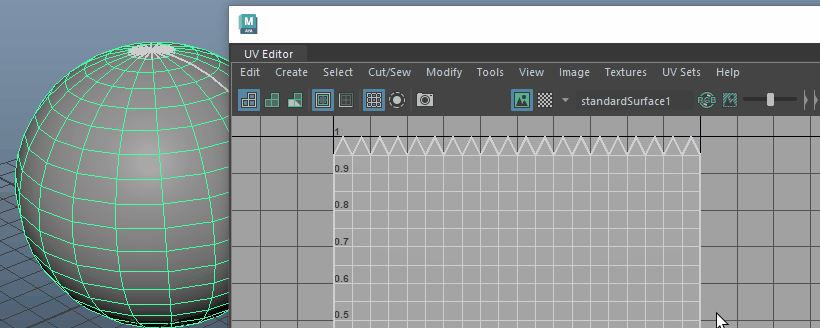

  1. Select the object and open the UV Editor (Windows > Modeling Editors > UV Editor).
  2. In the UV Editor toolbar, click the checker pattern shader icon or go to Textures > Checker Map.

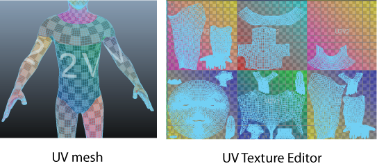

    The checker pattern shader is applied to the surface of your UV mesh and appears behind the grid in the UV Editor. Right-click to toggle between a simple black and white shader to a color gradient in the Checker Map options. The color gradient makes it easy to locate tiles on your UV mesh.

    In the following example, the size of the checkers is inconsistent, indicating that the texture is stretched in some areas.
