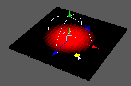

Creates and controls a falloff volume using an input object for its shape.

- Shape
- Sets the shape of the falloff area. Options include:
- Sphere: A gradient from the center to the edges of a sphere.
- Cube: A gradient from the center to the edges of a cube.
- Nurbs curve: A gradient along a curve.
- Particles: A gradient defined by the position of dynamic particles.
- Mesh: A gradient along a custom mesh shape.
