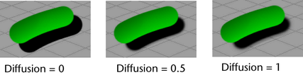

Shadow Diffusion
Controls the softness of the fake shadows. Higher values make the shadow edge softer.

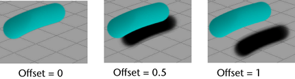

Shadow Offset
This setting is available only when Fake Shadow is set to 2D Offset. It controls how far the shadow is offset from the casting stroke.

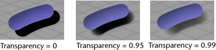

Shadow Transp.
This setting controls how transparent the shadows are. Higher values make the shadows lighter. Lower values make them darker.

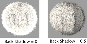

Back Shadow
Both back and center shading techniques are quick to render. The back side of an object doesn’t receive light, and is therefore not illuminated. Back Shadowing simulates this effect by shading the paint farthest away from the light. Higher values make the shading darker.

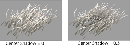

Center Shadow
By default, all tubes are painted at the same brightness. This setting shades tubes closest to the centre of the stroke path, simulating the effect of a clump of plants where the plants on the outside are illuminated, but the plants on the inside are shaded because the light is blocked by the outside plants. Higher values make the shading darker.
