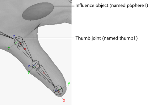

Now you can set up an influence object to create a hand muscle bulge by creating a polygonal sphere, setting the sphere as an influence object, then linking the sphere’s scaling to the movement of the skeleton’s thumb.
Set up the influence object
To create the polygonal sphere to simulate a muscle bulge
  1. Create a polygonal sphere, adjusting the scale attributes to approximate the muscle shape (for example, set Scale X to 1.5, Scale Y to 0.7, and Scale Z to 0.7).
  2. Position the sphere inside the hand, between the thumb and index finger.

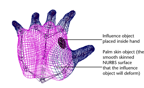

  1. Select the palm skin object. (This is the smooth skinned NURBS surface that the sphere will deform.)
  2. Select the sphere.
  3. Select Skin > Edit Smooth Skin > Add Influence.

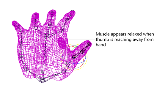

Now when the thumb is positioned away from the palm, the muscle appears to relax.

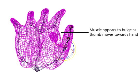

But as you rotate the thumb towards the palm, the surface bulges to simulate muscle action.
