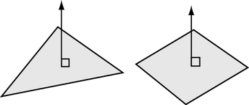

A normal is a theoretical line, perpendicular to the surface of a polygon. In Maya, normals are used to determine the orientation of a polygon face (face normals), or how the edges of faces will visually appear in relation to each other when shaded (vertex normals).
Face normals
The front of a polygon’s face is graphically represented using a vector called the polygon’s normal.

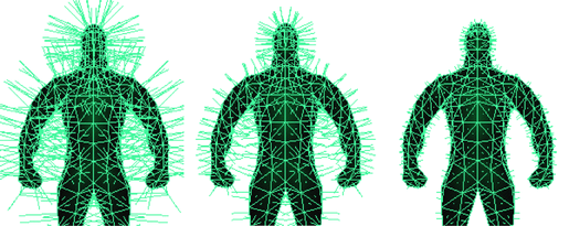

Vertex normals appear as lines projecting from the vertex, one for each face that shares the vertex.

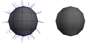

  • When normals for a particular vertex all point in the same direction (called soft or shared vertex normals), there is a soft edge transition between the faces in smooth shaded mode.

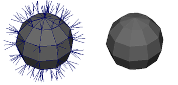

  • When the vertex normals point in the same directions as their faces (called hard vertex normals), the transition between faces is hard, creating a faceted appearance.
