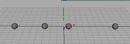

The rand(-10,10) returns a random number between -10 and 10 each time it executes. When you rewind the animation to frame 1, Maya might assign these values to the translateX attributes of the marbles:
Attribute Value
marble1.tx 2.922
marble2.tx 5.963
marble3.tx -4.819
marble4.tx 7.186

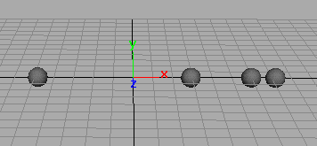

The next time you rewind the animation to frame 1, each marble’s translateX attribute receives a different random value. Maya might assign these values:
Attribute Value
marble1.tx -3.972
marble2.tx 9.108
marble3.tx -7.244
marble4.tx -3.065

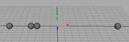

When you rewind the animation the first time, Maya might assign these values to the translateX attributes of the marbles:
Attribute Value
marble1.tx 8.020
marble2.tx -2.973
marble3.tx -7.709
marble4.tx 0.741
Each time you rewind the animation thereafter, Maya assigns these same values to the translateX attributes of the marbles. The marbles don’t move.
