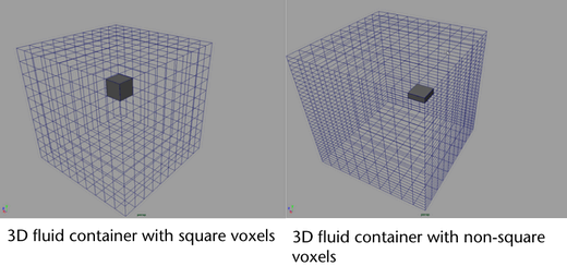

Fluid resolution is set along the X and Y axis of 2D containers and along the X, Y, and Z axis of 3D containers. You can adjust the resolution values proportionally along each axis, which results in square voxels in the container. Adjusting fluid resolution non-proportionately without adjusting the size to match, for example setting the resolution along the Y axis to a higher value than the X and Z resolution values, results in non-square voxels in the container.
To maintain square voxels in your fluid regardless of the fluid resolution, ensure that the Keep Voxels Square attribute is on. With Keep Voxels Square on, voxels in the container are kept square by keeping the X,Y, and Z Resolution values proportional to their respective Size values.
For example, if the X,Y, and Z Size values of a 3D container are 10, and the X, Y, and Z, Resolution values are 10, increasing the container's size along the Y axis to 20 results in the X and Z Resolution values being scaled down from 10 to 5. This ensures that the container’s voxels are kept cubic.
