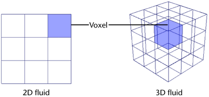

When you define a fluid property as a grid, you can place different property values in each individual grid unit called a voxel (volume pixel). Grids give you precise control over what the values are in the container. There are two types of grids: dynamic and static.

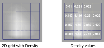

The following example of a 2D fluid shows Density in a grid. The image on the left shows the image in shaded display mode. The image on the right shows what the actual Density values are in each voxel.
Increasing the number of voxels that comprise a fluid container increases the quality of the rendered fluid image, but also increases the time it takes to render. Ensuring that the voxels in your fluid are square (2D container) or cubic (3D containers), also increases the quality of the rendered fluid image.
