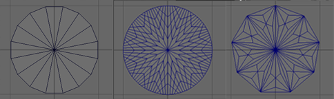

A polyDisc node is created whenever a disc primitive is created.
Sides
Determines how smooth the cap is.
Subdivision mode
Determines the shape to further subdivide each slice of the disc into. Options include Quads, Triangles, Pie, Caps, and Circle.
Subdivisions
Determines how many times the base faces are subdivided using the Subdivision mode.
Radius
Determines the size of the disc based on the edge length from the center to one side.
