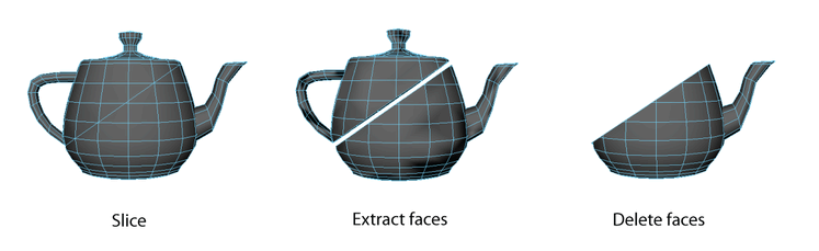

You can use the Multi-Cut Tool to slice polygons along a straight plane, and then extract or delete faces above or below the cut.

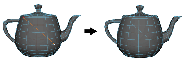

To slice a mesh using a custom plane

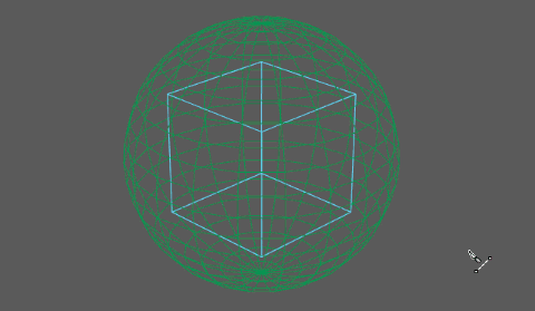

- (Optional)
Set a live surface for the cut edges to adhere to.
- Click on either side of your mesh to define two slice points.
An orange slice preview line appears between the slice points. This line represents the slice plane.Note: You can use grid (hold X) or point (hold V) snapping when placing slice points.
- Edit your slice plane by doing the following:
- Middle-drag to reposition the plane.
- Drag to reposition slice points.
- (Optional) In the Modeling Toolkit window, select Ignore Backfaces in the Slice Tool options if you only want to slice faces visible to the camera.
- (Optional) Otherwise, select
Delete Faces or
Extract Faces if you want to delete or separate the sliced faces respectively.
A dotted line perpendicular to the slice preview line appears, indicating the side of the mesh that will be deleted or extracted.
- Press Enter or right-click to cut the mesh along the slice plane.
