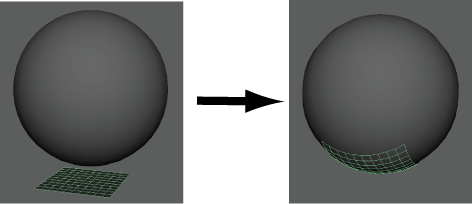

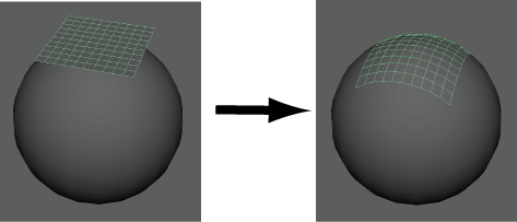

The placement of the wrapper mesh determines the section of the target mesh that is wrapped. In the following example, the sphere is placed at world origin. The plane wraps to different parts of the sphere depending upon its original location:
