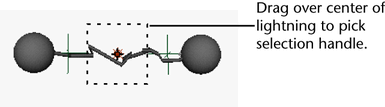

- Select the lightning you want to edit. Tip:You can select lightning in the Outliner or in the scene view. To select it in the scene view, you must pick the selection handle, which is located under the light icon in the middle of the lightning.

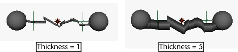

- Thickness
The Thickness attribute determines how fat the lightning is. It specifies the radius of the circle that gets extruded along the curve that makes up the lightning.

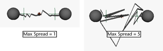

- Max Spread
Controls the amount of jitter in the lightning. The greater the value, the more the lightning jitters.

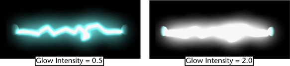

- Glow Intensity
Specifies the brightness of the lightning when rendered.

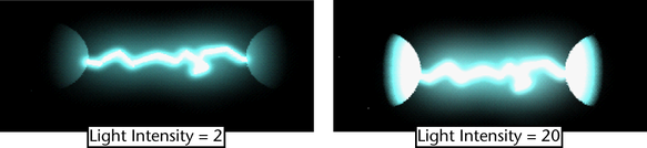

- Light Intensity
When you create lightning, a light at the center of the lightning is also created, which casts light on surrounding objects. The default intensity of the light is based on the Glow Intensity attribute, and the difference between the Lightning Start and the Lightning End attributes. The Light Intensity attribute multiplies this default intensity. Increase the value of Light Intensity to increase the lighting of the surrounding objects.

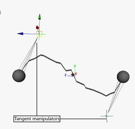

Position lightning
You can adjust the direction the lightning moves away from the start object or toward the end object using the tangent manipulators.
To position the lightning
- Pick the tangent manipulator for the end of the lightning you want to move.
- Using the Move tool, drag the tangent manipulator to position the lightning.
