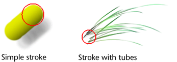

When you display the Paint Effects canvas, the Paint Effects Tool is selected automatically. The cursor shows the width of the stroke path. For simple strokes, the brush width defines the paint stamp. For strokes with tubes, the brush width defines the stroke path boundary—tubes can start growing only within the path defined by the brush width.
