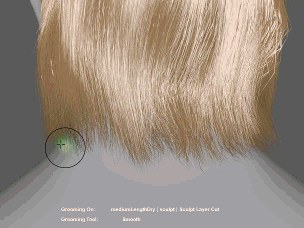

Brush Mode: Global
- Local
- Applies smoothing along the length of each hair in the brush radius. The amount of smoothing is average on a per-hair basis.
Use Local mode to affect small areas of the groom.
Local is the default setting.
Brush Mode: Local
