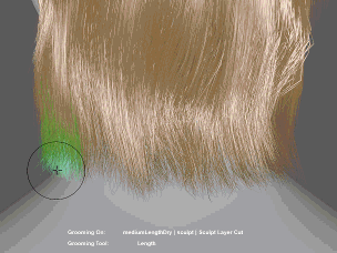

Floating
Continuously applies the length effect as you drag across the hairs. Each stroke is additive and applies length based on the Increment value until the Min or Max values are reached. Floating is the default setting.
Selection Mode: Floating

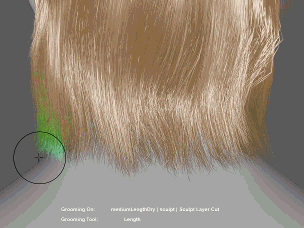

Locked
Isolates the brush's effect to hairs within the brush radius. Drag left to shorten and drag right to lengthen hairs within the selection.
Selection Mode: Locked

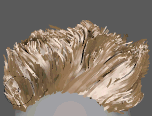

Global
Applies the width scaling along the length of each selected hair. The Brush Falloff Settings affect how the brush applies width scaling to the selected hairs.Global is the default setting.
Brush Mode: Global
