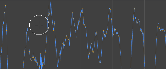

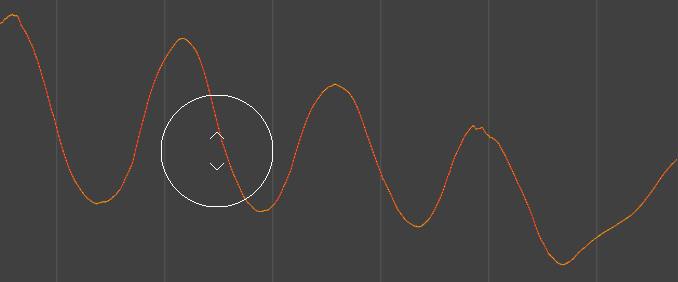

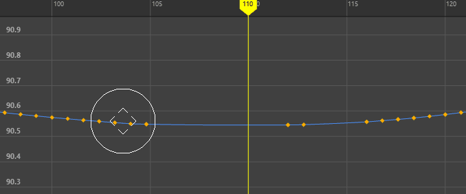

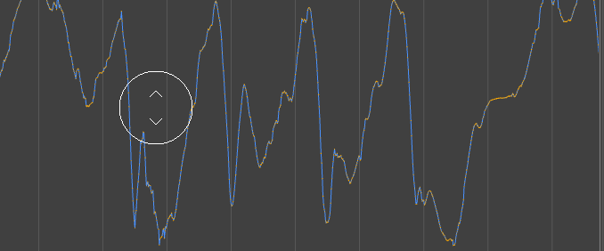

- Activate this option to sculpt curves on
both the Graph Editor Value and Time axis. The sculpt brush cursor changes to reflect whether you are in Value or Value and Time modes.
Left: Value only (default) cursor. Right: Value and Time cursor.

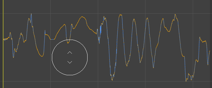

Grab Curve Sculpt tool with Affects Time active
Smear Curve Sculpt tool with Affects Time active

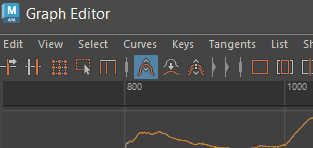

| To... | Do this: |
| Select keys to sculpt | Keys must be within the radius of the Sculpt tool brush
when you drag, as only keys
inside the brush circle are changed (unless the key or the channel is locked). Key outside the brush radius are unaffected.

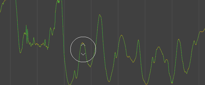

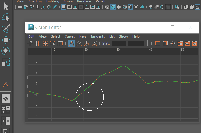

| Push keys up or down in the Graph View | Select the
Grab tool
from the
Graph Editor toolbar. You can also find the Grab tool in the Graph Editor
menu.
| Flatten keys on a curve in the Graph View | Select the
Smooth tool
from the
Graph Editor toolbar and drag over the curve you want to affect. You can also find the Smooth tool in the Graph Editor
menu.
| Spread keys on a curve in the Graph View | Select the
Smear tool
from the
Smear tool in the Graph Editor
menu.

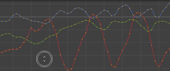

| Lessen keys on a densely-keyed curve | Select the
Key Reducer tool
from the
Graph Editor toolbar and drag across the curve you want to reduce. You can also find the
Key Reducer tool in the Graph Editor
menu.
![]() Note: The
Key Reducer Sculpt tool does not work on Quaternion Rotation Curves.

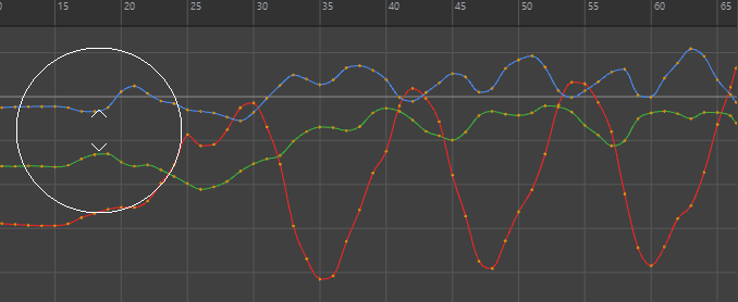

| Resize any Sculpt tool | Middle-drag any key sculpting tool left or right to scale it.
| Change the strength of the Sculpt tool | Middle-drag any key sculpting tool up or down to show a draggable strength level indicator.
