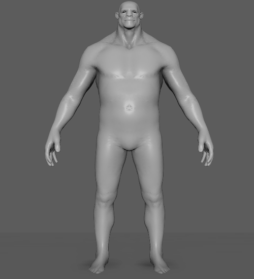

Symmetry options for retopologize let you create even edge flow on both sides of your mesh. When you run Retopologize with Symmetry turned on, your geometry is precut along the selected axis before the algorithm is run to ensure even distribution of topology on both sides of your mesh.

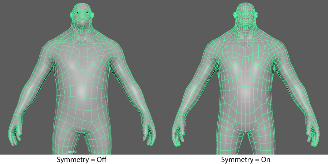

The following example shows a mesh that has been retopologized with and without symmetry enabled. When symmetry is turned off, the resulting shape appears symmetrical even though the topology is not. With symmetry turned on,
Retopologize produces a true centre line with even edge flow on either side.

The resulting mesh is symmetrical in both appearance and edge flow. In the following example, you can see a clear centre line after retopologize is run.
