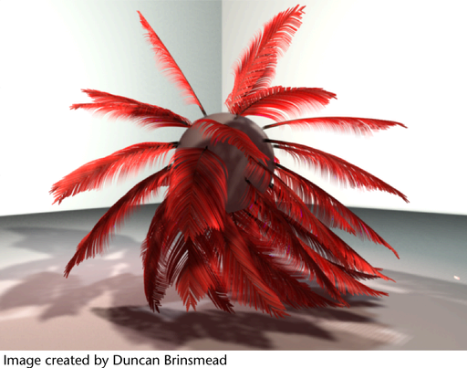

You can assign a Paint Effects brush to the nHair system. This is useful for creating effects, such as vines or feathers for hair. The hair output can be Paint Effects or NURBS curves.
To assign a Paint Effects brush to hair
- Select a brush from the Content Browser.
- In the Outliner, select the hairSystem.
- Select .
- The brush now replaces the hair. Depending on the brush, you may need to tweak the settings in the brush’s

Tip: To create your own hair look with polygons, you can create a mesh brush and paint a test stroke, then assign this brush to the hair system following the procedure above. Next, convert the Paint Effects to polygons. You can even texture these with hair images. The width attributes on the hair system still affect the polygons.
For a better looking polygon, before converting, decrease the brush width (0.05) and set flatness to 1.
