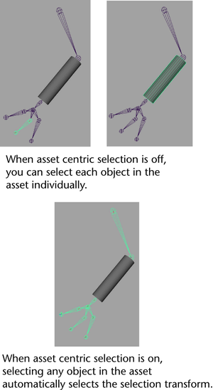

Asset centric selection
For assets with no transform, you can customize Maya to select the first published node of an asset (the selection transform, the first parent, or the first child in that order) whenever any node in an asset is selected in the main scene. This is useful in complex scenes, especially with hierarchies, where you usually only want to ever select the highest level parent in the asset.
For example, in a character scene where a skeleton and its skin are placed in the same asset, an animator may have trouble selecting the skeleton behind the skin. However, if the skeleton is published as the asset’s root transform, the animator could then select the underlying skeleton just by selecting the skin.

To select assets by their selection transform
- Hold the Q +
while the cursor is pointing to an object in the scene. - Select Select > Asset Centric from the marking menu.
Now if you select any object in the asset in the scene panel, the object that you set as the selection transform is selected instead.
