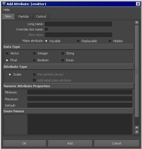

    The Add Attribute window appears:
  3. Enter a name for the attribute in the Long name box.
  4. Make sure Make attribute: Keyable is on.
  5. Select one of the following data types:
    Vector
    Creates a vector attribute consisting of three floating point values.
    Float
    Creates a floating point attribute.
    Integer
    Creates an integer attribute.
    Boolean
    Creates an attribute consisting of an on/off toggle.
    String
    Creates a string attribute that accepts alphanumeric entries as data entry.
    Enum
    Creates an attribute that accepts selections from an “enumerated” or drop-down list.
  6. Select one of the following attribute types:
    Scalar
    Creates a per object attribute that you can set to a single value that applies to every particle in the object. A vector scalar is considered a single value with three numbers.
    Per particle (array)
    Creates a per particle attribute. You can set this type of attribute to different values for each particle.
    • If you select Scalar, you can specify Minimum, Maximum, and Default values for a Float or Integer attribute.
      Minimum and Maximum set the lowest and highest values you can enter for the attribute in the Attribute Editor or Channel Box. Default sets the default value displayed for the attribute. Because you’re going to control the attribute’s value with an expression, you might want to skip entering values for these options.
      An expression isn’t bound by the Minimum and Maximum values. The attribute receives whatever value you assign it in the expression. The expression can read the attribute’s Default value or any other value you give it in the Attribute Editor or Channel Box.
      When you select Scalar, you can’t create a counterpart initial state attribute by turning on Add Initial State Attribute.
    • If you select Per particle (array), you can also create a counterpart initial state attribute by turning on Add Initial State Attribute. See Understand initial state attributes for details.
      You can’t set Minimum, Maximum, or Default values for an Array attribute.
  7. Click Add if you want to add more attributes. Click OK to add the attribute and close the Add Attribute window.
