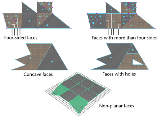

Fix by Tessellation
It’s possible to modify polygon meshes using some of the polygonal editing operations and produce polygonal faces with attributes that you do not want. For example, four-sided faces, faces with more than four sides, concave faces, faces with holes, and non-planar faces. These options let you clean up these problems by tessellating (triangulating) the offending faces.
The following illustrations show the kinds of problems you can encounter with polygonal faces.
