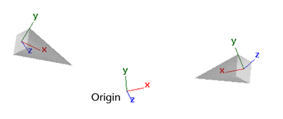

For example, suppose the Aim Position is set to the origin of the workspace, and the world space Y-axis (0, 1, 0) is the Aim World Up value. An instanced object’s X-axis (1, 0, 0) is the Aim Axis value, and the object’s Y-axis (0, 1, 0) is the Aim Up Axis value. As the instanced object moves from left to right in the workspace, the object has the following orientation:
The object’s X-axis points directly at the origin wherever the object moves in the workspace. The object is rolled around its X-axis as necessary to keep its Y-axis aiming up as much as possible. Up is defined by the Aim World Up setting, which in this case is set to the world’s Y-axis.
