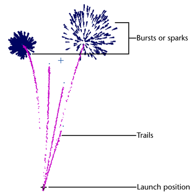

You use the Fireworks effect to make fireworks displays quickly and easily. The effect creates a number of rockets that fly up, leave a trail as they fly, and burst. Gravity fields are also created for all particles. Initially, the effect randomly chooses colors and positions for rocket launches and bursts. You can edit these defaults later. The fireworks are rendered in software (not hardware) as streaks.
Before you create fireworks, it is helpful to review the terminology used in the Fireworks effect.

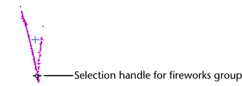

Start by selecting the fireworks group selection handle.

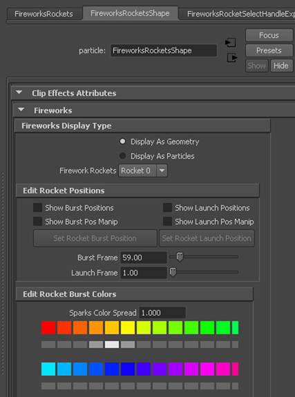

To select rocket attributes

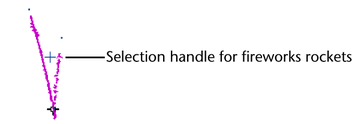

- Select the rockets selection handle, placed in the center of the fireworks rockets.
If the rockets selection handle becomes hidden behind the rocket trails, try drawing a selection box in the center of the Fireworks effect.
- Open the Attribute Editor.
- Turn off Auto Load Selected Attributes, under the List menu.
The auto load option must be off to prevent the wrong node from displaying.
- Click the FireworksRocketsShape node in the Attribute Editor.
- Navigate to the Clip Effects Attributes, Fireworks section.

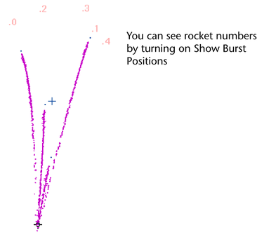

- Select the rocket you want to edit in the Firework Rockets pull-down list.
You can see the number of each rocket by turning on the Show Burst Positions or Show Launch Positions checkbox.

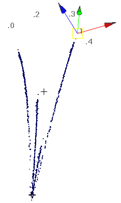

To edit rocket burst or launch positions
- Select the rocket attributes as explained in To select rocket attributes.
Remember to click Load Attributes if the Attribute Editor is not refreshed.
- Turn on Show Burst Pos Manip or Show Launch Pos Manip.
Note:If the node in the Attribute Editor changes, you must turn off Auto Load Selected Attributes, under the List menu. To redisplay the FireworksRocketShape node, select the rocket group and click Load Attributes.
- Move the burst or launch manipulator as needed.
- Click Set Rocket Burst Position or Set Rocket Launch Position once the manipulator is in position.
- If the rockets have already been drawn, replay the animation from frame one to see your changes.
To edit rocket burst or launch times
- Edit the Burst Frame or Launch Frame attributes.
Maya tries to satisfy the burst time as close as possible by computing an appropriate velocity and trajectory for the rocket.
To edit rocket colors
- Edit the color attributes described below.
- Sparks Color Spread
Sets the number of colors used in the rocket’s burst sparks. The spread appears on either side of the main color you choose in the sparks color palette.
- Sparks color palette
Enables you to select a spread of colors for the rocket’s burst sparks. Click the rectangle under the main color you want, and the other colors in the spread are chosen from either side of it.
By default, the palette consists of colors chosen in consecutive order around the color wheel. You can change the palette one color at a time by clicking the color square, which opens the Color Chooser. Or, you can use the Remake Color Palette option.
