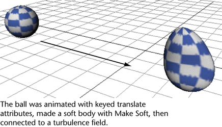

Converts the object to a soft body. Select this option if you haven’t animated the object and will animate it with dynamics (for instance, a field). Also use this option if you’ve used nondynamic animation on the object and want to keep the animation after you create the soft body. Nondynamic animation includes keys, motion paths, non-particle expressions, and deformers.
Dynamics that affect the soft body’s particles are not affected by momentum from the nondynamic animation. The dynamics occur in the particle object’s local space, which are uninfluenced by other animation on the object.

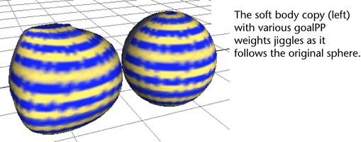

Makes a copy of the object a soft body without altering the original object. If you use this option, you can turn on Make Non-Soft a Goal (described later) to make the original object a goal object for the soft body. The soft body follows the animated goal object. You can edit the goal weight of the soft body particles to create rubbery or jiggling motion.
For instance, suppose you make a sphere a soft body with Duplicate, Make Copy Soft and Make Non-Soft a Goal selected. Next, you set keys to animate the motion of the goal object, which is the original sphere. You then give the particles of the soft body copy various goalPP values. When you play the animation, the soft body copy deforms like jiggling gelatin as it follows the original sphere. Note that you’ll typically hide the original sphere by turning on Hide Non-Soft Object.
