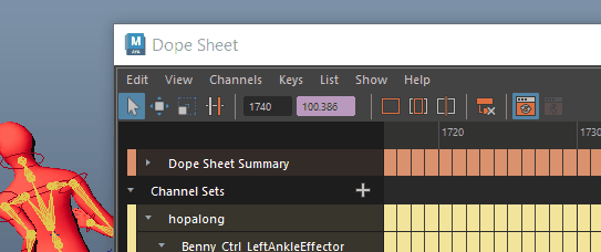

Create a Dope Sheet Channel Set
  1. In the Dope Sheet Outliner, click the "+" (plus sign) next to Channel Sets. A new Channel Set appears below the Dope Sheet Summary area.
  2. Give the channel set a name.
  3. Shift-select attributes and middle-drag them on top of the Channel Set to add them.
