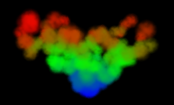

Example: Using particle age to color particles
  1. Make a cone emitter emitting upwards with a speed of 8, set the particles’ Lifespan Mode to Constant with a Lifespan of 2, and set their Render Type to cloud.
    To do this, you can copy the following MEL commands from the Maya Help and paste them into the Script Editor:
    emitter -pos 0 0 0 -type volume -r 100 -vsh cone -alx 8; particle; connectDynamic -em emitter1 particle1; setAttr particleShape1.lifespanMode 1; setAttr particleShape1.lifespan 2.0; setAttr particleShape1.particleRenderType 8;
  2. Select the particle shape and display the Attribute Editor.
  3. Select the particleCloud tab, and press the button next to Life Incandescence to display the Create Render Node window.
    Tip: Incandescence is the same as color but is self illuminating so you don’t need to add a light.
  4. In the right panel, click .
    This creates a new ramp, a texture placement node, and a Particle Sampler Info node. Life Color isn’t actually an attribute at all—it’s just a control in the Attribute Editor that tells Maya to set up these connections to color for you.
  5. Play the scene back and render.
    You’ll see the particle color textured by the ramp as the particles age.

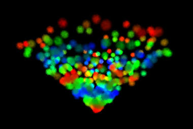

  7. Turn on Inverse Out Uv and re-render.
    The colors are reversed—instead of the particles changing from red to green to blue, they change from blue to green to red.

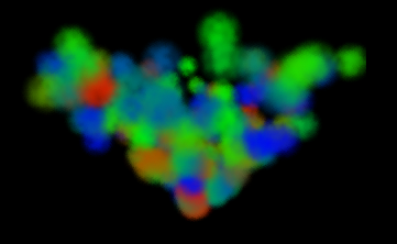

  11. Set Noise UV to 1.0 and 1.0 and re-render.
    Noise is applied to the placement of the ramp creating randomness in the red, green, and blue particles.
