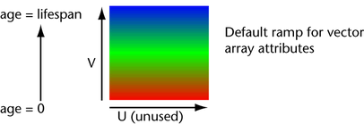

    The Attribute Editor displays the default color ramp that controls the attribute. The three component values of the attribute are set to the RGB values of the vertical component (V) of the ramp over the particle’s lifetime. Values at the bottom of the ramp are used at the beginning of the lifespan, values at the top are used at the end of the lifespan.
    By default, at the beginning of each particle’s lifespan, the left, middle, and right vector components of the attribute equal 1, 0, 0 because the RGB value at the bottom of the ramp is red (1, 0, 0).
    At the middle of the lifespan, the vector components equal 0, 1, 0 because RGB is green (0, 1, 0). At the end of the lifespan, the vector components equal 0, 0, 1 because RGB is blue (0, 0, 1). Maya interpolates vector components between these three points.
  5. Edit the ramp’s RGB color values as desired (see Rendering for details).
    You can use any numerical values for R, G, and B in the Color Editor when you edit ramp values. Values outside the range 0 to 1 are valid, but they have no meaningful color equivalent in the display of the Texture Sample swatch. Do not edit HSV values or you’ll likely get incorrect results.
    The only attributes for which the color in the swatch necessarily represent the component values of the attribute are rgbPP and incandescencePP. For other attributes that don’t have color equivalents, you can edit color values in the Color Editor by entering values in the R, G, and B boxes rather than by clicking colors directly.
    For example, you can set rampAcceleration to 100, 0, 0 at some point in the lifespan by setting R, G, and B values of the corresponding point in the ramp to 100, 0, 0. These values create a red color in the ramp that’s identical to 1, 0, 0. However, adjacent points in the swatch will be interpolated with 100, 0, 0 differently than with 1, 0, 0.
    You can also change the color sequence by changing other ramp attributes in the Attribute Editor such as Noise and Noise Frequency. See Rendering for details on the ramp attributes.
    Remember, the horizontal component (U) of the ramp has no effect on the attribute by default. More precisely, the controlling component of the ramp is the leftmost vertical edge of the Texture Sample swatch in the Attribute Editor. To use the horizontal component as well, see Customize per particle attribute control with ramps below.

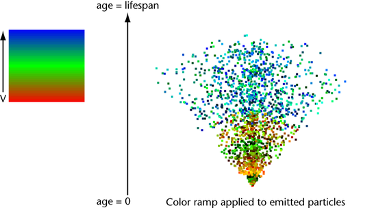

    An example of a default ramp applied to emitted particles follows:

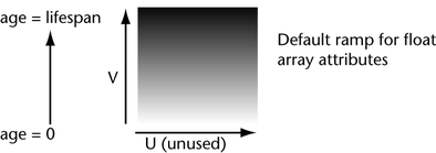

Use grayscale ramps
You can use a grayscale ramp to change float array attributes as particles age. When you create a ramp for a float array (per particle) attribute, the attribute is connected to a grayscale ramp. In grayscale ramps, black represents a value of 0 and white represents a value of 1.
For information on advanced ramp features, see Ramp Shader.
Note:
If you create a ramp for emitterRatePP, you control the emission rate over time for a directional or omni emitting particle object. The attribute exists in the particle object that emits, not in the emitted particles. You cannot control lifespanPP with a ramp.
To use a grayscale ramp
  1. Select the particle object.
  2. Open the Per Particle (Array) Attributes section of the Attribute Editor, then right-click the desired attribute and select Create Ramp.
    This creates a default ramp that controls the attribute as the particles age.
  3. In the Lifespan Attributes section of the Attribute Editor, set the Lifespan Mode to Constant and the Lifespan to the number of seconds you want the particles to exist in your animation.
    If you are working with emitterNameRatePP, set the Lifespan to the number of seconds you want the emitter to exist. The emitting particle object will disappear after the Lifespan value specified.
  4. In the Per Particle (Array) Attributes section of the Attribute Editor, right-click the attribute box for which you just created a ramp, then select arrayMappern.outColorPP > Edit Ramp.
    The Attribute Editor displays the default grayscale ramp that controls the attribute. The values of the attribute are set to the R color values in the vertical component (V) of the ramp over the particle’s lifetime. Values at the bottom of the ramp are used at the beginning of the lifespan, values at the top are used at the end of the lifespan.
    By default, at the beginning of each particle’s lifespan, the value of the attribute equals 1 because the R component at the bottom of the ramp is 1 (The color is white, with an RGB value of 1, 1, 1.)
    At the middle of the lifespan, the value of the attribute equals 0.5, because the R component at the bottom of the ramp is 0.5. (The color is gray, with an RGB value of 0.5, 0.5, 0.5.)
    At the end of the lifespan, the value of the attribute equals 0, because the R component at the bottom of the ramp is 0. (The color is black, with an RGB value of 0, 0, 0.)
    Maya interpolates the values between the three points in the ramp.

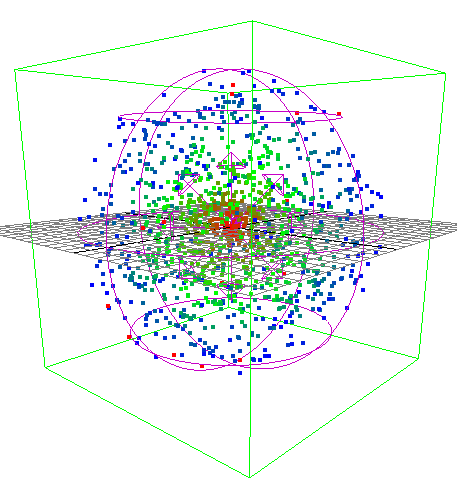

Ramp example
Coloring particles according to distance from origin
In this example, we’ll use the V coordinate of a ramp to color particles according to their distance from the origin. This example uses emitters and fields, which are covered in the following chapters. You may want to read about emitters and fields before doing this example. Or you can cut and paste the MEL code into the Script Editor to create the emitters and fields.
To use a ramp to color particles according to their distance from origin
  1. Create a sphere volume emitter. Set the Volume Speed attributes as follows: Away From Center to 1; all the other speeds to 0. Set Scale (10, 10, 10).
    To do this, you can copy the following MEL commands from the Maya Help and paste them into the Script Editor:
    emitter -pos 0 0 0 -type volume -r 100 -sro 0 -nuv 0 -cye none -cyi 1 -spd 1 -srn 0 -nsp 1 -tsp 0 -mxd 0 -mnd 0 -dx 1 -dy 0 -dz 0 -sp 0 -vsh sphere -vof 0 0 0 -vsw 360 -tsr 0.5 -afc 1 -afx 1 -arx 0 -alx 0 -rnd 0 -drs 0 -ssz 0 ;
    scale 10 10 10;
    particle;
    connectDynamic -em emitter1 particle1;
  2. Apply a radial field with Volume Shape set to Sphere to the particles. Set the Magnitude to -2, set Attenuation to 0, and disable Use Max Distance. Turn on Volume Exclusion and set Scale to 10, 10, 10. This will keep the particles inside the volume.
    radial -pos 0 0 0 -name pushIn -m -2 -att 0 -typ 0 -mxd -1 -vsh sphere -vex 1-vof 0 0 0 -vsw 360 -tsr 0.5 ;
    scale 10 10 10;
    connectDynamic -f pushIn particle1;
  3. Add per-particle color to the particles.
    To do this, you can copy the following MEL command from the Maya Help and paste it into the Script Editor:
    addAttr -ln "rgbPP" -dt vectorArray particleShape1;
  4. Select the particle and display the Particle Attribute Editor. In the space to the right of rgbPP, click the right mouse button and select Create Ramp > to display the Create Ramp Options.
  5. Set Input U to None (the default), Input V to rgbVPP, and Map to New Ramp (the default). Click OK.
    Notice that a new attribute called rgbVPP appears in the Attribute Editor.
  6. Right-mouse-click next to rgbVPP and select Runtime Expression (before or after dynamics calculation). In the Expression Editor, copy and paste the following line, and click Create:
     rgbVPP = mag( position ) / 10;
    The quantity mag(position) is always equal to the particle’s distance from the origin. We’ve divided by 10, which is the maximum distance any particle can be from the origin in our setup.
    In other words, this expression says that the V input to the ramp will have a value 0 if the particle is at the origin, and 10 if it’s all the way out at the boundary of the sphere.
  7. You may also want to make the particles a little bigger.
    To do this, you can cut the following MEL commands from the Maya Help and paste them into the Script Editor:
    addAttr -is true -ln "pointSize" -at long -min 1 -max 60 -dv 2 particleShape1;
    setAttr "particleShape1.pointSize" 4;
  8. Now turn on smooth shading, rewind. and play the scene.
