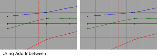

Using Add Inbetween will cause the animation’s keys to be shifted by one whole time unit forward from the current time.

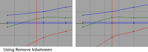

Using Remove Inbetween will cause the animation’s keys to be shifted by one whole time unit backward from the current time.
