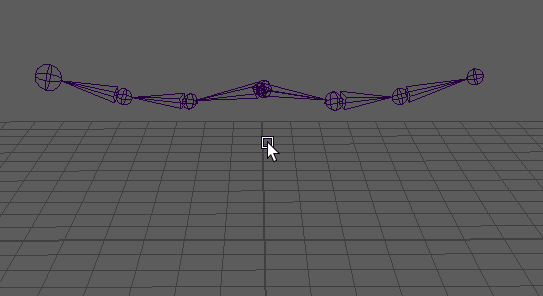

    After creating symmetric joints, removing the symmetry connection lets you modify each joint independently.
  1. Select a source joint and do one of the following:
    • Right-click and select Break Symmetry from the marking menu.
    • Select Delete by Type > Constraints from the main menu.
    The symmetry connection is broken.
    Note: To break all symmetry connections on the entire hierarchy, Right-click the root joint and select Hierarchy before selecting Break Symmetry from the joint marking menu.
    To break the symmetry on the Joint chain, right-click and select Hierarchy
