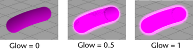

Glow
Defines the brightness of the standard glow, which is produced by applying paint stamps. A value of 0 produces no glow. Higher values add more glow. This glow effect is less effective on strokes with textures, but adequately adds glow to effects like stars. For more realistic glow, see Shader Glow below.

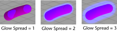

Glow Spread
Defines how much the glowing halo of a standard glow spreads past the paint. This number is a factor of the width. A value of 1.0 produces no spreading. A value of 1.5 makes a halo 1.5 times as big as the width of the stamp.
