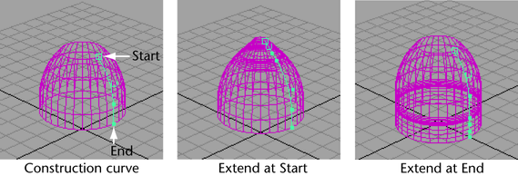

Extend Curve At
Start extends the curve from its start point.
End extends the curve from its end point.
Both extends the curve at both ends.

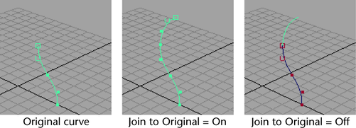

Join to Original
Attaches the curve extension to the original curve. If off, the input curve and the curve extension are independent objects. You can transform the extension separately.
