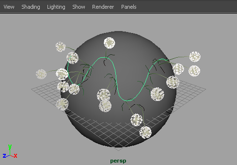

To paint on NURBS or polygonal objects, you must first make the objects paintable. When you paint directly on a paintable object, Paint Effects creates a curve on the surface along the stroke path and attaches the stroke and new brush to it. When you translate the object, the stroke moves with it. You can offset the brush from the surface.

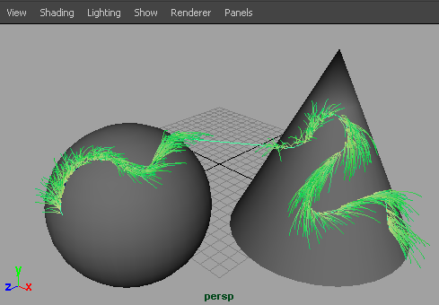

As you paint, the stroke does not leave the surface unless you paint over another object that is paintable. If you do paint across another paintable object during the stroke, the stroke will continue on the other object, bridging the two objects.

  • Because the stroke attempts to stay on the surface, the result may be unexpected. For example, suppose you have a sphere intersecting a plane. If you start painting on the sphere, once the brush leaves the sphere, it looks for another surface to continue on, the plane in this case. However, if you start to paint on the plane, the brush never leaves the surface, so the stroke doesn’t continue on the sphere.

  1. Select the NURBS or polygon object(s) you want to paint on. If you are in the scene painting view, Ctrl-click (Windows and Linux) or Control-click (Mac OS X) on an object to select it.
  2. In the Modeling menu set, select Generate > Make Paintable.

  3. Select Generate > Paint on Paintable Objects.

  7. In either the scene view or the scene painting view, drag across the plane.
