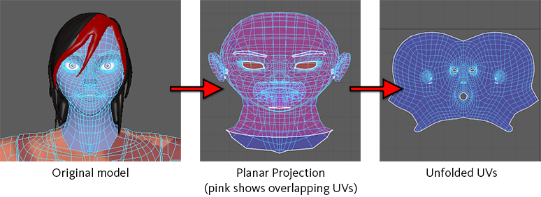

Planar mapping projects UVs onto a mesh through a plane. This projection is best for objects that are relatively flat, or at least are completely visible from one camera angle.
Planar mapping typically gives overlapping UV shells. The UV shells may be perfectly superimposed and look like a single UV shell. You should use after mapping to separate overlapping UVs.

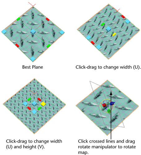

- Click Best Plane to position the manipulator based on the faces you selected.
- Click Bounding Box to position the manipulator based on the bounding box of the mesh.
- Choose the axis from which UVs will be projected.
- Click Project.
- Use the projection manipulator to control how the plane distributes UVs.
- Use the
UV Editor to view and edit the resulting UVs.
You can also rotate the manipulator by clicking the red crossed lines, which reveals the Show Manipulator tool. Click the light blue circle around the Show Manipulator handle to activate the rotate handles.

- Projection mapping only works properly on a single object at a time. If you need to apply a projection to multiple polygonal objects in a single step, combine the objects into one, apply the projection, and then separate the parts back out. Otherwise, perform a projection on each object separately.
- When a model’s form is very organic, and you require a complete UV representation of that model for texture mapping, a planar projection can produce UVs that overlap and appear distorted. You will probably need to
unfold the UVs to make them usable.
