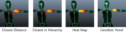

While legacy bind methods create artifacts, and Heat Map binding often fails on real-world meshes, the Geodesic Voxel bind method addresses these issues by using a voxelized representation of your character, computing the bind weights, and then applying the resulting weights to the existing closed-form skinning method, deforming the character's geometry.
The following image compares the default weights assigned for a character's left arm joint using the three different bind methods.
